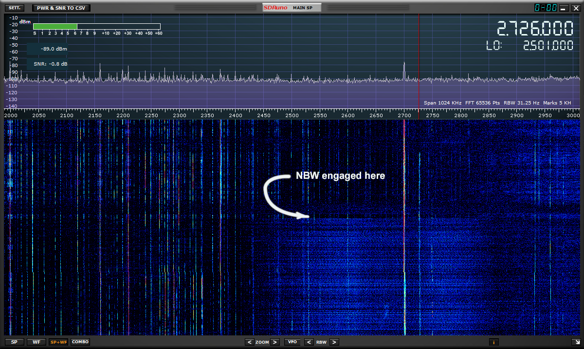

In another case, we have line noise - a nasty 60 Hz "spark gap" sounding buzz that just permeates the frequencies from 2450 to about 2850 kHz (I suspect an electrostatic air cleaner) - and the NBW (Noise Blanking, Wide) feature takes it out completely. With NBW engaged the buzz is just gone.
In other cases - some like what you describe - I imagine the noise ought to be easy to take out, yet NBW just won't do much with it.
I suspect there must be some pretty specific parameters for the algorithm that we just don't have control over. The feature may need an entire panel of controls.
I've found that the trick to getting the most out of NBW is to lower the NB setting in the EX CONTROL panel to the point where the noise is masked as well as possible, yet not so low that nearby strong signals start to intrude into the listening experience. I find a good general point for the NB control to be around around 160.
